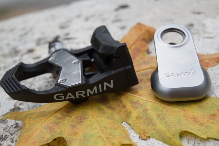

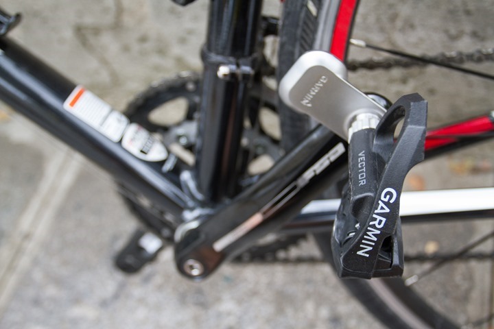

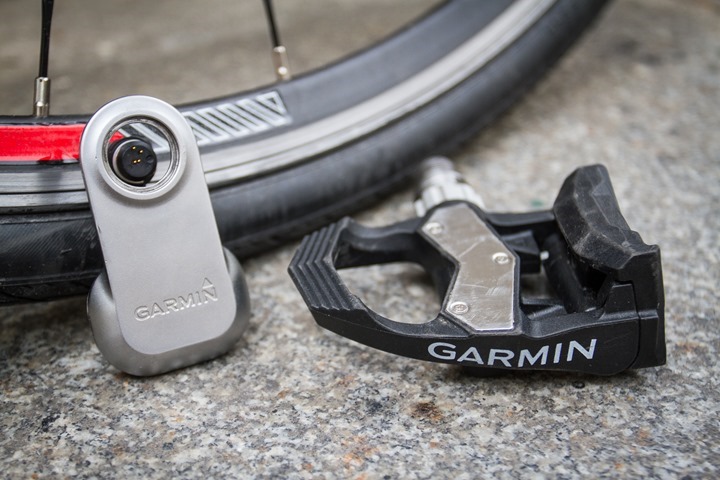

When it comes to what’s in the package, you’ll get the following:
  • - 1 left sensing pedal with Garmin Vector (the pedal looking thing)
  • - 1 right pedal with no sensor (just to match the left)
  • - 1 Vector communications pod (the silver pod looking thing)
  • - 2 cycling shoe cleats (for left/right)
  • - Some o-rings
  • - Some metal washers
  • - 1 ANT+ mini-USB stick for firmware updates/configuration
All of which you’ll attach to the left hand-side of the bike, just like this (except for the ANT+ stick):
Volledige tekst: http://www.dcrainmaker.com/2014/08/anno ... amics.html
